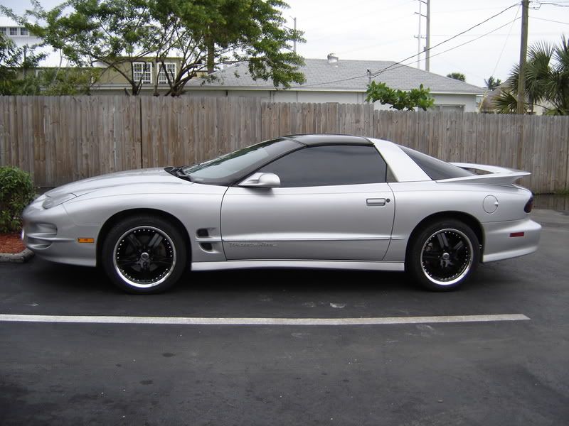

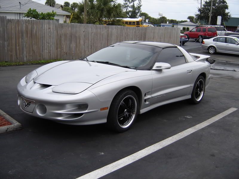

http://i34.photobucket.com/albums/d1...e/DSC00741.jpg
http://i34.photobucket.com/albums/d1...e/DSC00738.jpg
http://i34.photobucket.com/albums/d1...e/DSC00736.jpg
dont really have any better pics of mine than that
