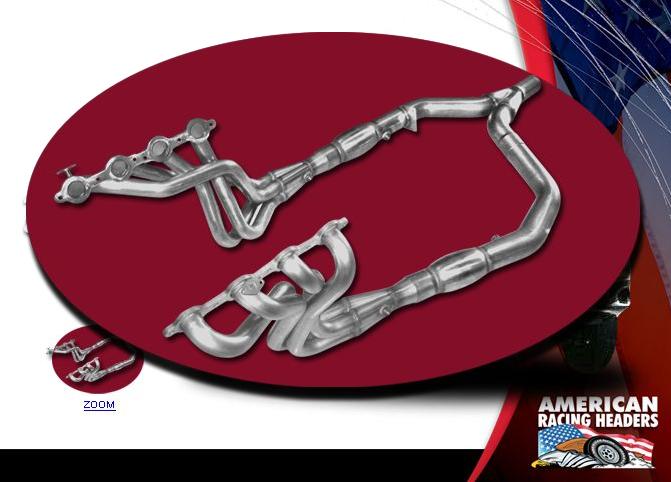

ARH:
http://www.ws6project.com/user_stor/...s/FbodyARH.JPG
The basic difference is the Kooks y pipe is one pipe cut into the other one, whereas ARH has a better, smoother "true" merge design. Both are great designs. I wouldn't imagine the average person would feel any difference, but as we all know all of these small differences add up or show up on the dyno, if you're a dyno queen.
At second glance, it also looks as though the Kooks y pipe on the driver side has been flattened to resolve any clearance issues, I don't know if this smaller diameter would affect flow.
The shape does affect flow- think of it like water- a nice, straight pipe flows water very smoothly. Sharp bends will slow the flow. Changes in shape can cause disruptions in the smoothness of the flow. When applied to air, you create turbulance as you create disruptions. A poorly designed Y increases that turbulance and increases the amount of rasp. The goal with mandrel bends is to keep the flow as smooth and consistent as possible. This is the way I always understood it, but I'm sure there are people better qualified than I am to correctly explain it. :worship:

ARH or Kooks are the two top, ARH just has a better design and clearance if you're into that sorta thing.

Kooks has to crush their y pipe to make it fit. ARH does not have to crush their y pipe to make it fit.
Every installer I know says ARH tucks up nicer than Kooks despite not crushing their y pipe. I don't know what else to tel you. lol :Poke:
