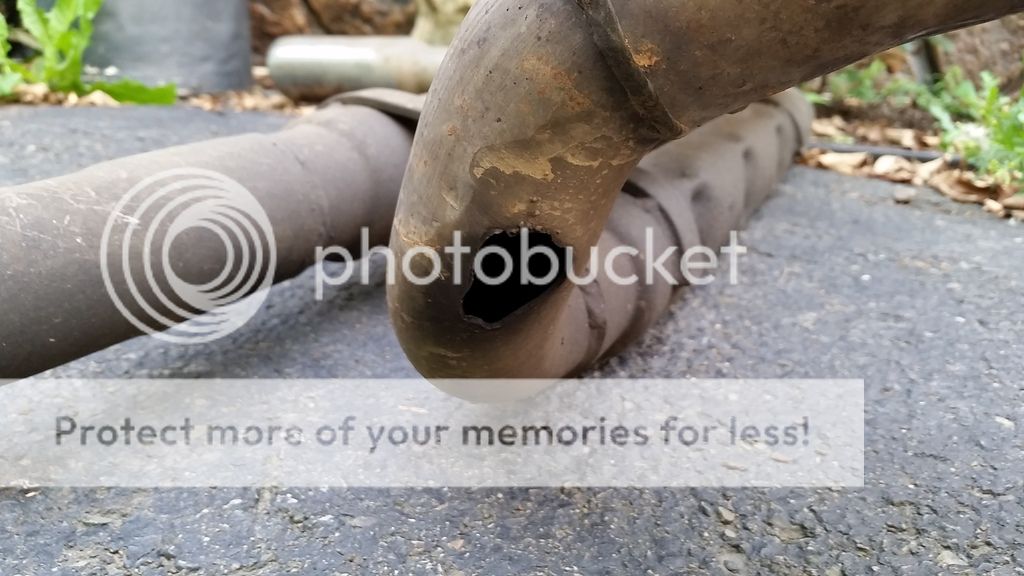

Think I found where the ticking sound was coming from on my car...car had Hedman longtubes when I bought it "not the best in the world" and it looks like the weld where one of the EGR bungs was at finally gave out and it just blew the bung off...started as a tick "hairline crack probably" and now my car sounds like a 1982 Chevy Truck with exhaust and no cats...
Time for stainless long tubes and new exhaust.

Hahaha Pat I was going to suggest that but wasn't sure if you removed your egr stuff. I had a similar ticking noise last year and after using a broom handle I was able to pin it down to a gasket on the block off plate. Glad it wasn't more.
Hey, there's a hole in the header tube! :D
bondo
a competent Welder should be able to close it and not cost as much as new headers
I agree with what Scott says, but I personally wouldn't be investing any money on headers that were that old and already rusted like that.

I have all the EGR stuff blocked off but the headers that were installed on my car before I got it still have the bungs "or had them" for the factory EGR equipment. Guess god decided I need to pollute the world a little more than usual and blew the welds :chuckles:

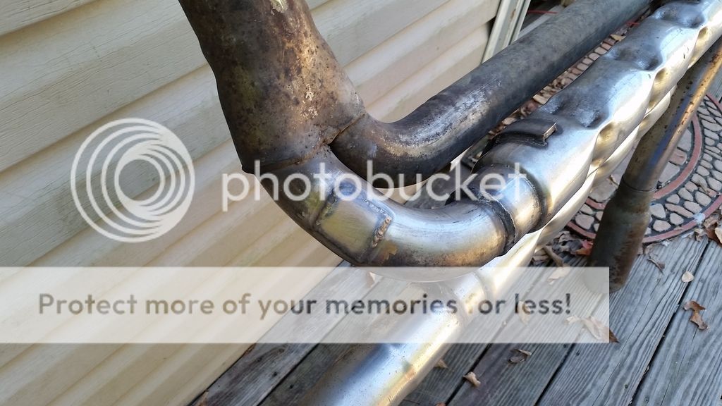

Definitely repairable.
A skilled welder did this for me.
