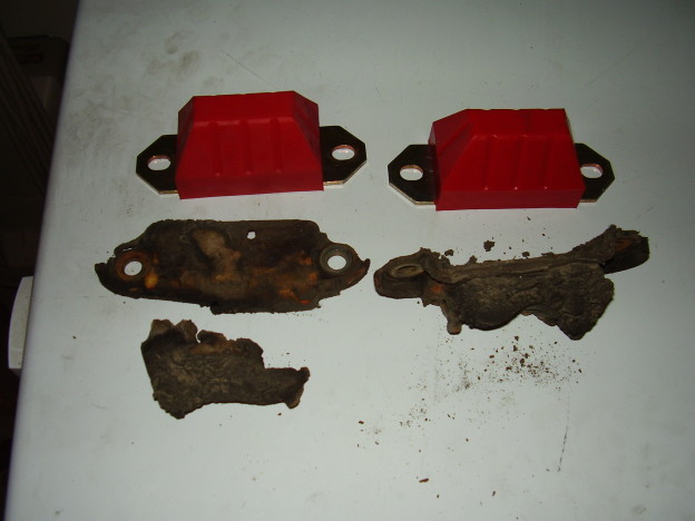

And it is only happening on the passenger side. It has only very occasionally cut into the size a small amount before, but over the 4th weekend I had a couple friends come in from out of town and we took the bird out one day and with right around 600 extra lbs in the car it was riding so low that unless I was driving on a perfectly level road any bump at all caused the turn downs on the dumps to scrape. Yep, I upgraded the bump stop some time ago with the Prothane 1-1301 kit. Here is a shot of what the stockers looked like when I pulled them off the car next to the replacements.

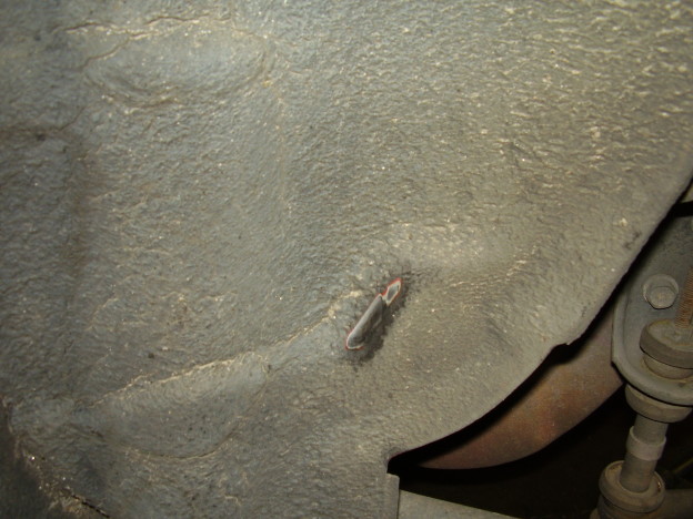

The stockers were so worn down that I had a contact spot in the driver side wheel well where it rubbed off the factory coating.
